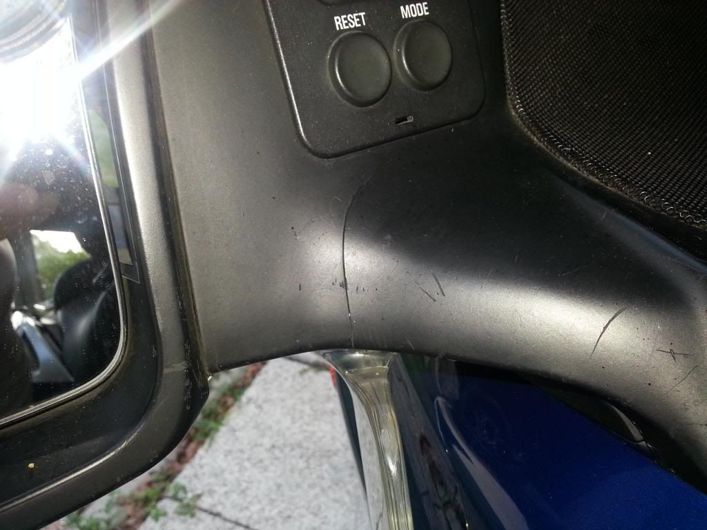

Ok, so now my LT is 14 and showing some signs of aging. The dash around the instrument cluster is needing some attention. Haven't had much luck using epoxy on other plastic type materials and was wondering if anyone has done repairs to their tupperware. Right now my plan is to use epoxy with some fiberglass mat on the back side. Gonna get the area clean and scuff it up for better adhesion. Also the speaker grill foam has deteriorated and will need replacing. I think there are about four other areas that need some epoxy also. I noticed some old repairs had been made using some yellow epoxy that lasted but don't know what kind was used.

After counting the small breaks, mostly bolt holes, and cracks there is at least 12 and so I quit counting. I just went ahead and ordered a new dashboard on line for $190 delivered. The old one would just keep breaking and cracking do to age and continued UV damage. I pulled the speaker screens off cause the new one won't come with them. Gotta put some speaker foam on the screens as well.
