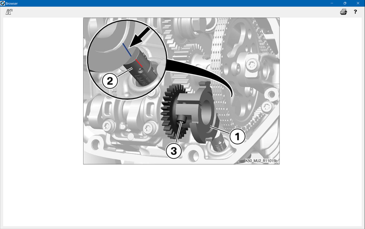

#31 ·
The mark on the wheel must be at the beginning of the groove in the pick up
Thank you for shearing that information. Just to make it clear, the shiftcam alignment is to the left side of the sensor's flat part, as marked in red, as it has no groove like the water cooled on your picture. This is all based on the manual pictures as I haven't opened up my shiftcam as yet.
