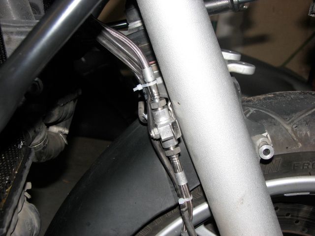

The banjo bolts, etc. Take a bit of effort to get moving, but my real hang-up is that I don't have a way to join the front lines. The original ones are joined by a permanently-connected aluminum block. How do I get my lines to connect like the ones in this pic (from this forum)?

While this is still on my "to-do" list I see 3 lines in the picture of your lines that look like they will thread into the junction block T" like the ones in the picture. Starting from the top of your picture it looks like lines #2, #3 and #4 are what you are wanting.
However, it does appear that you are missing the "T". I would think that this should have come in the "Kit". Call Speigler and see what they say.

You use the one already on the bike. Just remove the 3 old hoses from it & install the 3 new ones.

No you will not. They left out the aluminum block from your set. That crossover tube will go into it. You cannot re-use the stock one. I just got mine this week and it had a block, not the bolts like your set has, just the block and washers. Looks like they threw the wrong "bag of goodies" into your kit. Give them a call and they will fix it.

Yep! Like JZ says, they left out the block. Put my set on last week and it came with a new block for the three lines to attach to just like the original. Bummer. Give them call on Monday--I'm sure they will get one out to you.

Just confirming that my set came with the block (for both my LT and my C) so they just forgot to include it with your set. Call them up and let them know, I am sure they will get you a new one.

I would not recommend using the factory (BMW) T block due to risk of galvanic corrosion.

Yep... Speigler is shipping one out.
