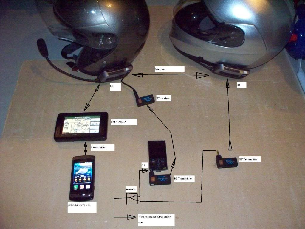

Well I finally got something working. Everything works as it should, I wired into the speaker wires a 1/8" stereo jack, plugged a "Y" connector into it and plugged in 2 BT transmitters. One BT transmitter goes to my SO helmet directy as she does not need the GPS or phone BT connection. The second goes to a BT receiver and plugs into where the hard wire MP3 plugs. All works great and the BT transmitter and receiver work perfectly and are full stereo.
