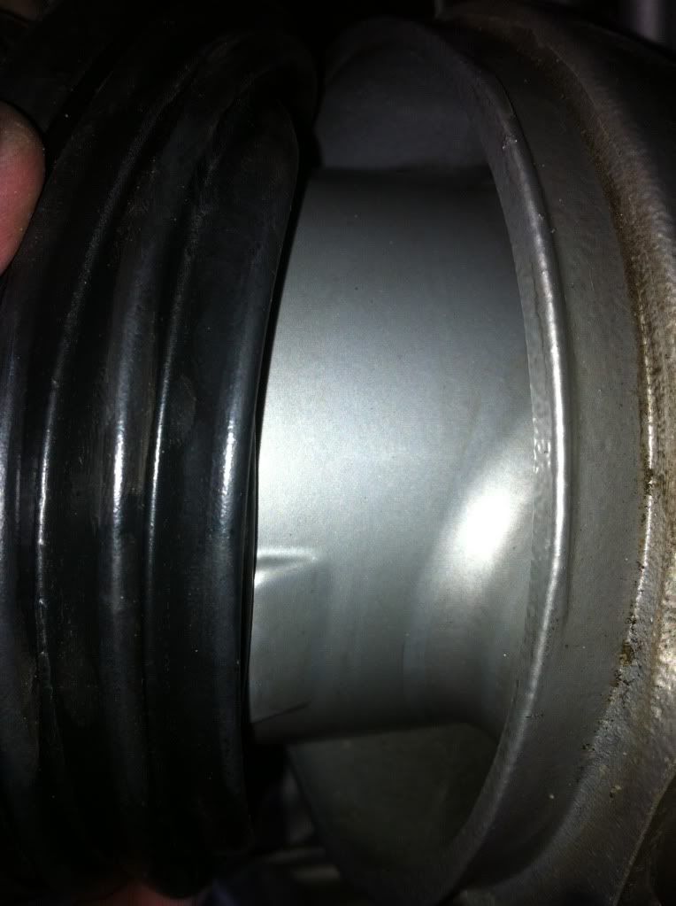

I also notice a "pull back" effect during acceleration.. it is more obvious when the temperature is high... as such, my acceleration is not linear.. i have initially thought that my FD is gone.. so i did a check by pulling back the rubber cover on and check for oil but none was visible but it bothers me..... anyone can help with this??
no oil sighted
