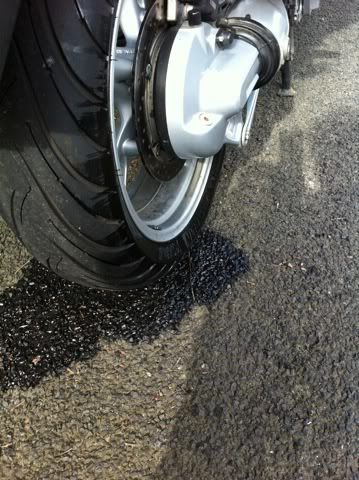

I have had an 1150RT for almost 3 years and in that time have found 3 different ways to cover my rear tyre in oil:
1) not seat the donut gasket on the valve cover correctly.
2) blow a seal in the rear suspension
3) perforate a crown gear seal in the final drive
So I get no surprises, are there any more ways to oil a rear tyre?
Ian
