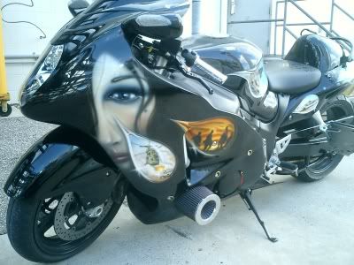

Just wanted to drop in and say hello. A little about me..... I'm a speed freak by heart, but lately I have been looking for a cruiser. I found a K1200LT that has totally stole my heart. It's a 2001 with 6K miles on it. Its been kept in an airconditioned shop and looks like new. I am stoked about this bike. I can't sleep at night just waiting to pick it up. I should take delivery of the bike next week and will post pics of it a soon as I can. Here's a pic of my current bike. It's a Turbo Hayabusa with a GT35R turbo stage III race kit, sporting 550HP at the weheel. Told I was a speed freak...LOL... Pics of the K1200LT coming soon.

And Hello to you too. Nice paint job, your own work? or did you get it done for you. There is a thread currently running about custom paint jobs, you might be able to contribute to that. Anyway, welcome and enjoy the bike.

Thanks for the welcome. I had the bike painted in Pasadena at Mike Milburns paint shop. The artist was Don Tipton (TIP).
