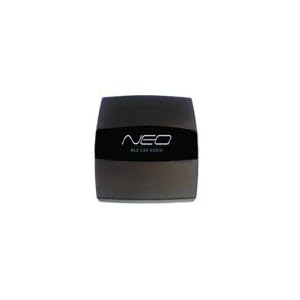

I just swapped out my CD changer for the Neo ProLink 2.0 POD2BMWV1 Ipod connector. Works like a charm. Has to be one of the easiest mods you can do. You could run cables to get your iPod / iPhoneconnector up in the Oddments box, but I chose to leave it in the Side bag since it's an iPod bought for this explicit purpose. Again very easy, 4 screws to remove the CD changer, unplug the cables from the changer, plug them into the cable adapter for the Neo Pro, plug in the iPod and ready to roll.
It's worked really well, though there was a couple of time I had to unplug the iPod and plug it back in, if that proves to be a pattern I may end up running the cable up to the front so I don't have to get in the side case to do this.

Yes the track information shows right up on the control head, it's pretty sweet, it comes with a card that tells you what you can do with each CD, for example switch to CD 2 and you can move from one play list to another, displaying the play list name, once you have the play list selected switch back to CD1 and you can then switch from one song to another and back, there is a slight pause on the song switch but only about a second. I think CD3 allows you to go through Artist list and CD 4 allows you to choose Pod casts.
I spent a little time watching the power behavior with the iPod plugged in you can see it go to Charging when the Radio power is turned on, it remains charging no matter if you are using AM/FM, Aux, Intercom, Stingray CD or the iPod. Once you turn the Radio power off it stays on charging as long as the Key is on, watched it for about 4 minutes with the key on radio off. Once the key was turned off, locked steering wheel position the iPod continued to show charging for about two minutes then switched to looking like it was disconnected. Turning the Key on and then the radio the iPod went back to Charging mode. So it doesn't look like it will draw on the battery with the key off.
