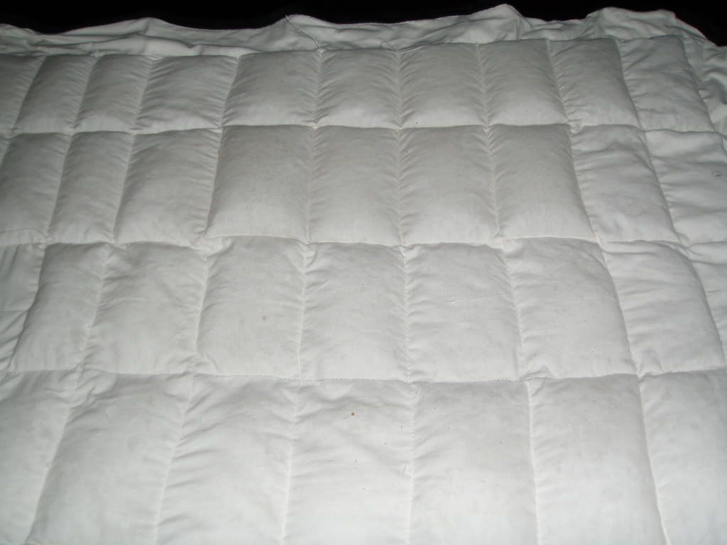

Here are the instructions I found on-line

1. Pre-wash Muslin fabric to remove sizing.
Stop right here!!!! She's about to take you down the bunny trail. Let me dumb this down a little bit.
Buy the stuff listed above or find/buy at a thrift store a 100% cotton sheet at least 200 thread count. Muslin is kind of spendy and boring but a sheet laying around the house is just right!
Cut 2 pieces of material 22" x 54" and lay one piece on top of the other.
Mark a 2" wide border all the way around the edge of the material. DO NOT SEW THIS BORDER OR YOU WON'T BE ABLE TO ADD CRYSTALS
Fold the material in half so it is approximately 22" x 27" and crease the material along the fold. Find the center of the fold and trace an 8.5" diameter circle for your head to poke through.
Sew around the head hole but don't cut it out yet
Open the material back out flat and using the fabric pen make 5 equal width marks from the 2" marks at the side of your material (this will be the front of your vest) Should be approx 4"
Mark 1 3/4" up starting at the bottom of the vest (front) and continue marking all the way to approximately 6 rows from the bottom of the neck on what will be the back side of your vest.
Got everything layed out with the fabric pen? Then sew all of the horizontal seams starting at the bottom of the front of the vest and working your way to the last row on the back of the vest..
Then sew one of the center vertical seams from the bottom of the front of the vest to the neck opening. Then continue sewing the seam down what will be the back side of the vest.
Now a note about the crystals. They expand a TON. If some of your little pockets are a little larger then you might want to add a few more granules but be very careful. Too many granules and they will force themselves through the mesh of the material and get the fabric all slimy!
The smaller ones around the neck area should be filled with less than 1/4 tsp.
Using the funnel and hose put 1/4 teaspoon of the granules in each of the pockets row by row placing the granules against the sewn vertical seam. After you have filled every row from the bottom front front to the middle of the back then sew the vertical seam that will lock in those crystals. Continue doing this until all of the pockets have been filled and sewn on 1/2 of the garment (left or right side) then finish by filling and sewing the other half of the garment.Cut the neck hole out and sew that ribonny stuff around the inside of the hole.
Sew the ribonny stuff around the perimeter of the the vest and you are done.
Note: I used only 2 pieces of fabric couldn't figure out what to do with the 3rd piece
The picture above shows the vest after 1 1/2 hrs ride at 87*F and then left all night in an air conditioned house.
Weight of vest with no water estimated to be 10 - 12 ozs 284-340 g
Initial weight filled with water 9 lbs 10 ounces 4.37kg
Weight after ride and living in AC for hours 6 lbs 7 ounces 2.92kg
General observations: I ride year round with Olympia mesh gear. After the ride my skin was very cool to the touch. I expected my shirt and skin to be wet but both were absolutely dry, just cold. Nice!
