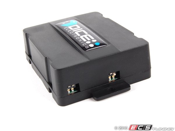

I wish I could remember. It was one of the first models DICE came out with for the K1200LT. It had a square black case, and two double DIP switches. I had no volume issues, and i had scrolling text. The Only problem I had at times was that it locked up if I tried to scroll through the songs too fast.

Back in 2006, I purchased a I-BMW-T DICE unit for my '99LT. This was a pre-silverline duo unit and it fully worked as advertised. I even had scrolling text on my radio display! I remember the DICE unit had two sets of DIP switches which needed to be set in a certain manner. It also did drain my battery a few times even if there was no iPod left plugged in.
This is what it looked like:
So, it sounds like something was configured wrong, or you may have had a defective unit or wiring harness.
