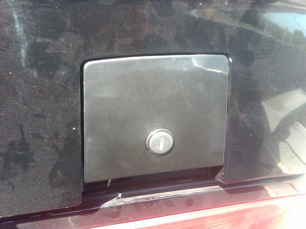

Just noticed the other day that my trunk latch is cracked in the top right corner.
I've read posts about the repair kit available , but my question is, is this repairable or does it need to be replaced? It still functions properly; no issues closing or locking.

mine did the same thing,,,i took that side pin out...trunk closes fine and no water gets in..this winter i may try to fix it so it dont look broken but i wont put that side pin back in
3,137 Posts
As was already mentioned, you WILL want to remove the pin for the right side latch!!! If you do not, it will eventually not disengage when you go to open the trunk and it will be a bear to get open then! I had the samething happen at CCR and John Z thankfully reminded me to remove the respective pin so as to not get stuck on the way home!

I cut both of my pin's down to .130 in diameter where the latch closes on them & it closes nice & easy. I use my top case rack all the time for transporting things and didn't want just one latch holding the top down.
Lenny, how did you get it out? Also, this sounds like a temporary solution. How long have you had yours with the pin out?​
How secure is the latch with only one pin?​

I have ridden around (unaware!) with my trunk latch not even closed and there was no indication of any problem. Unless you are high speed or hit some serious bumps I don't think it will even move. And for a couple of your questions, see below:
"How do you remove the pin?" All you need to do is remove a small Circlip on one end of the respective pin.
"Is it secure with just one pin?" Yes! Especially if you have a rack bag on top of it. We rode from Vermont to here (Portland Oregon) with only one pin. No probs!

Dave, some of us don't have a lathe (or the ability to use one if we had one) so I have been trying to think of an alternative to "pin trimming".
What would happen if the original pin was removed and replaced with a similar (or maybe smaller sized) piece of brass wire. The wire, being so much softer than steel, would bend at the point where the arms grab the pins and allow the latch to secure on both sides but with minimal downward pull against the latch.
The brass would bend into the shape of a flying V.

take a pin out and see how it closes than try the other side. what ever pin is easier to have in and close with no effert,,leave the other out...yhere will be no ill effects

I turned the pin with the most wear down on a lath until the wear marks where gone. That's how I ended up at .130. The reason removing one pin won't work for me is because I use my top rack all the time to haul things as much as 50 or 60 lbs. My LT is my only vehicle. I haul crankshafts & up to 7 sets of connecting rods at a time for work. With only one pin I am worried the top could open up on one corner under hard braking. It sure does close easy with the pins cut down & is still waterproof.
