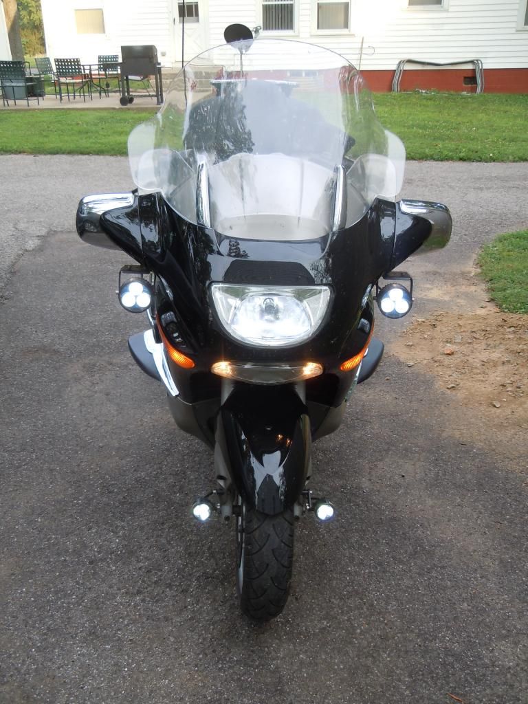

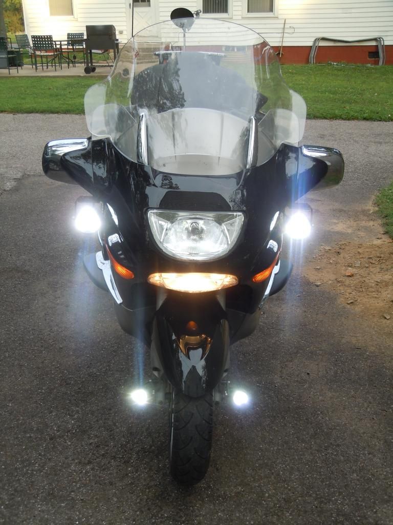

I've had a pair of Clearwater Lights Kristas installed for 2 years now. They are installed under the mirrors; they work just fine, but I don't have the same degree of conspicuity of something mounted lower (the "triangle" effect) so I had a pair of Darlas installed where a lot of guys have Motolights.
The Kristas have 2400 lumens each; the Darlas, 2000 lumens each. If I did not already have the Kristas I would go with their new light - Erica, at 6000 lumens each. Our own Brett on this site has Ericas on his new K1600GTL.
See post #3 for some additional info on how they are used.
lights off (ignition off):
lights at low setting (15%), for daytime conspicuity:

Looks great! Can you switch on the uppers separate from the lower lights or all four on the same switch?

No, the lower lights are always on with the ignition, like Motolights without a switch. A Clearwater-provided switch turns the upper lights on/off only. So, your choices are: lower lights only or all 4 lights.
All 4 lights are dimmable with the Clearwater-provided dimmer switch, between 15%-85%. The high beam switch sets all 4 to 100%; and, when you press the horn button all 4 lights go to 100%.

How did you mount the Darla's on your forks? I have been looking for a good alternative to the Motolights. Can you post some pics of your mounts? Thanks. Looks great!
