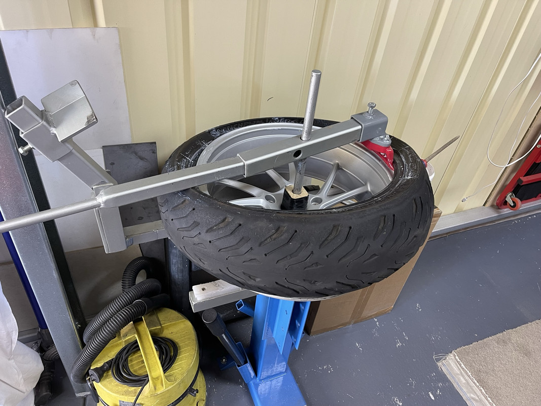

What I recommend :D is bolting the thing down to the floor, like my Frankenstein setup:
I know, that's not how your changer was designed...
