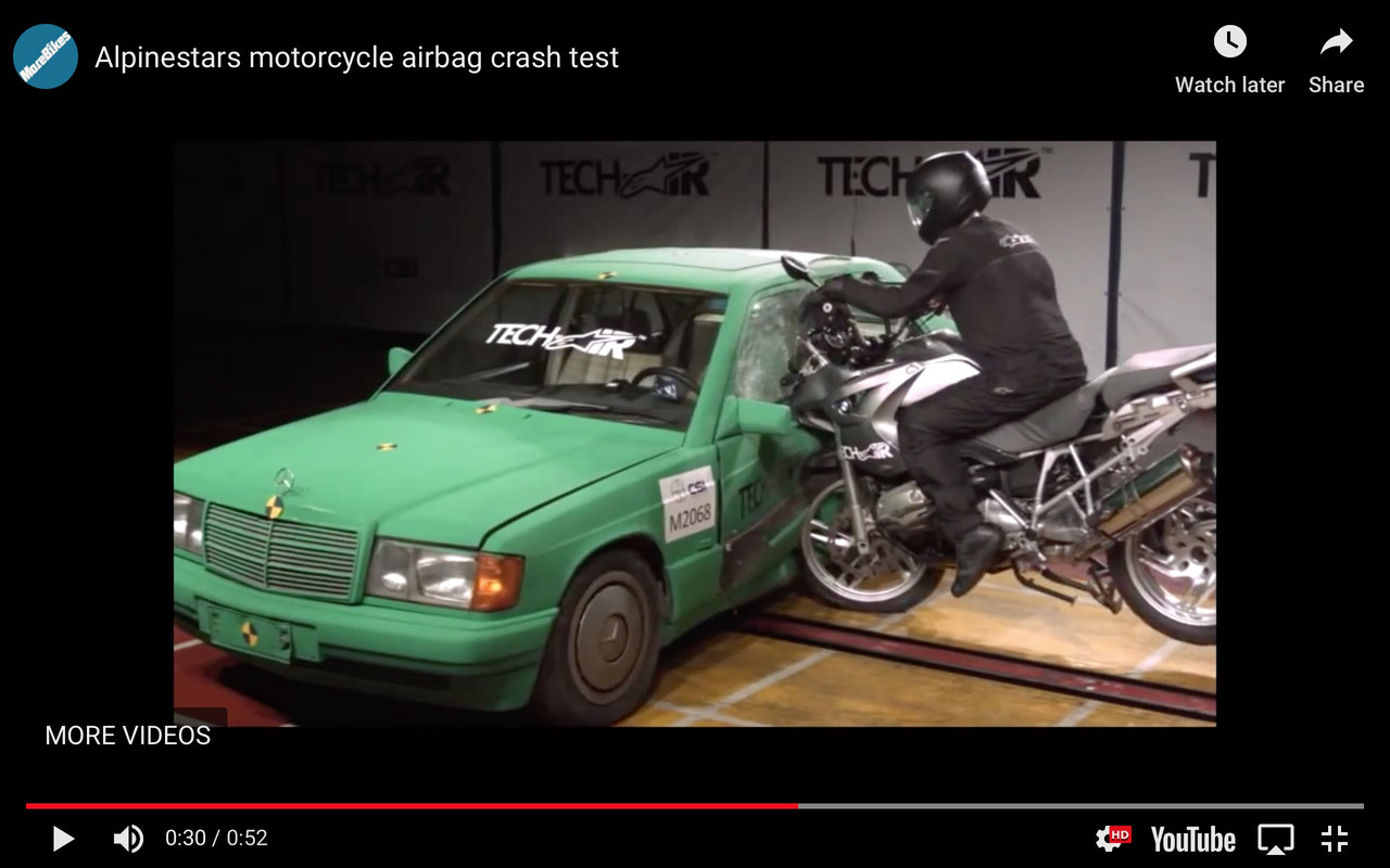

Alpinestars Tech-Air 5 System
Tech-Air 5 is a slim, self-contained wearable airbag vest designed to be worn under virtually any jacket. The system provides unrivaled upper body protection uniquely covering the rider's shoulders, critical in motorcycling accidents, in addition to the chest, ribs and full back. The Tech-Air 5 Airbag System offers the most comprehensive coverage of any motorcycling airbag available today.
The state-of-the-art Tech-Air 5 System features six integrated sensors (3 gyroscopes and 3 accelerometers) to continuously monitor the rider’s position. An algorithm developed closely with MotoGP race data and data from over 2,000 lab-simulated crash scenarios determine when and how the system deploys. The airbag has a maximum inflation time of up to 40ms (or less, depending on vest size). The impact absorption while wearing the airbag results in a decrease of impact force by up to 95% compared to a passive chest or back protector. Inflation time is quick enough to deploy the airbag before the rider's first impact with an obstacle. In addition, the vest will protect stationary riders in the event of a rear-end collision.
The airbag has a battery life good for 30 hours of riding time on a single charge, and an LED display conveniently shows system status directly on the garment. The system features Bluetooth connectivity to pair with the Tech-Air App, which uses the rider’s phone to display the system’s operational status, battery status and provide detailed analysis of a ride. Over-the-air firmware updates are also handled through the app. Alpinestars includes a micro USB charger for quick recharging.

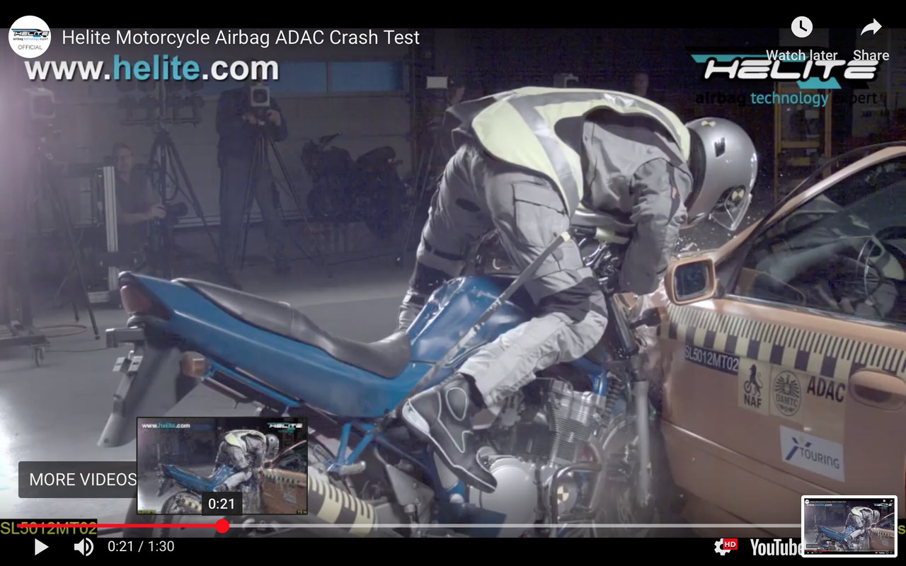

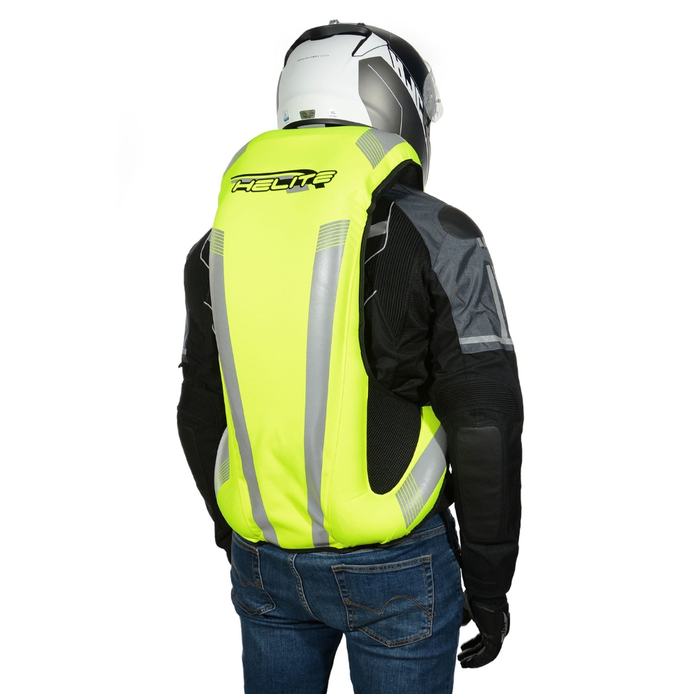

I'm just playing devil's advocate here because the common reaction when something new comes along and one is fully invested in something else the go-to reaction will often be biased towards being closed, defensive, etc. And this is the house of tethered vest users. As of today, I still like what I see in the external turtle design it just looks potentially more effective. Is it for sure? Given everything we've talked about here so far, I'm not certain if the other attributes discussed (no tether therefore no forget to connect, 7-8x faster deployment, automated contact to your listed emergency contact instantly in a deployment) won't offset that potentially greater efficacy. So much of whether or not something will be useful in a crash depends on the specifics of the incident. In large populations no doubt both designs can play very meaningful roles, and sometimes not. If I had to choose today, it would be the Helite Turtle 2. Before going there I plan to try on a properly fitted Tech Air 5, under my two Olympia jackets, one 3-season which I prefer as it's mesh and good enough, and one 4 season which fits tighter. I tried on the 4-season after removing the back protector and it seems it would easily accommodate the 4cm (1.57in) minimum circumferential clearance, and I almost always use the 3-season so my jackets will work I'm pretty sure.
As I'm OK w/ the technology part the main issue for me comes to comfort wearing it. As I reflect on all of the touring days I've done it's common for me/us to stop every 90min or so to take a whiz, grab some food or fuel. So in a 10h riding day that's 5 or 6 times on and off with the tether at a minimum if not the vest itself depending on ambient conditions, whereas you don't need to do anything w/ the internal vest. You can take your jacket off to cool and leave the vest on. So convenience is a potential issue.
