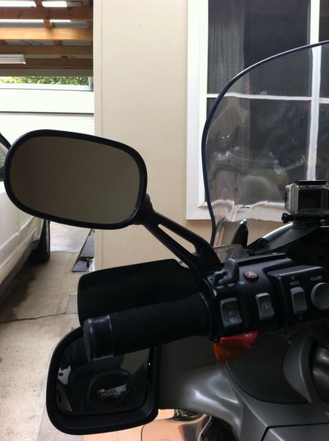

I went for a V-stream to get better airflow over the stock short Euro screen that came on mine. They are polycarbonate (like the OEM) and can take a thump. The bike flipped onto its right side 2 years ago and hit hard enough to break the windshield motor arm and the plastic surround, but not a scratch on the screen... it just flexed and went back to normal.
The mirrors miss the screen by a country mile...
Left mirror, full right lock... windscreen in fully down position
Right mirror, full left lock
I see grip puppies on your LT and some form of wind screen for the grips. What is that?

Re: RS mirrors on LT
Grip puppies... love em.
The handguards are to help stop rain and cold winds (when it gets cold) getting to my fingers.
While the heated grips are good when its really cold, I still find the tips & tops of my fingers getting sore/numb.. so rather than having heated gloves which are pretty impractical down here or those bulky mits, I made up some handguards...
So are those homemade , err handmade?
is this you?
http://s128.beta.photobucket.com/use...20for%20winter
I have never seen handguards for an LT before... interesting idea..

yep, thats me... an idea born from a need that wasn't met by available products (thread)
actually the ones in the pics are my v1 guards..., kept the colder air off a little but not the rain, so I made a v2 which curves over more at the top, which are the ones in the pics above.
Tony (deputy5211) scored the original ones, though I've not heard if he's tried them yet (wake up Tony! )
Pain in the arse to make... I did try to make a mould but the shape wasn't quite right, and the end product needed some added manipulation (brute force) and extra fibreglass to get it to nearly the right shape.
Another couple of months till it gets cold down here again and I really see if they help.. although I do know they help keep the rain off.
What do your pictures/video look like from that camera perch?
Is it there permanently or do you move it to other locations? Satisfactory results I would not know until my riding season a couple months hence. It has been a collection of ideas for me also on this forum most of which I can't duplicate, wish I could though.
ride safe
billsmith is offline
post #26 of 26 Old Jan 29th, 2013, 11:34 pm
I use that every time I ride as a "crash cam" just in case, eg click..... its protected from the weather there too (I use a skeleton case)
There's a recent thread somewhere about positions, look in Photography I think..
Cleanest and most stable position I've found is just in front of the windscreen, the adhesive pads WILL come off the paintwork with care.
My mount point is a bit wobbly now, it just needs some extra padding but its been there for about 3 years and done many km's.
