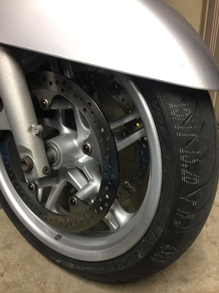

Ok to mix an Avon Storm 3D X-M front with a Metzler 888 rear?
Installed ME-880's on front and rear when I first bought the bike.
Front ME-880 now needs replacing after 16,000 (speedo does run about 10% high).
Still wasn't down to wear indicators but cupping was significant. Didn't want to take it on any long hauls on it.
Due to a puncture, the rear 880 got replaced with an 888. It still has good tread.
I bought the matching Avon for the back but thought I'd put some more miles on the 888 before replacing.

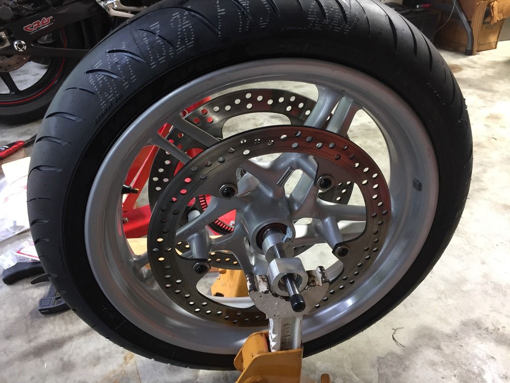

Just finished mounting / installing the Avon.
Was a little concerned when I couldn't find a red or yellow dot.
Looked online and someone mentioned they are balanced before they leave the factory, ego no dots.
Either I got lucky or that's true.
The lite spot of the wheel by itself is opposite the valve stem, off maybe 20 degrees.
Took one 1/4oz to balance. Pretty much opposite the valve stem too!

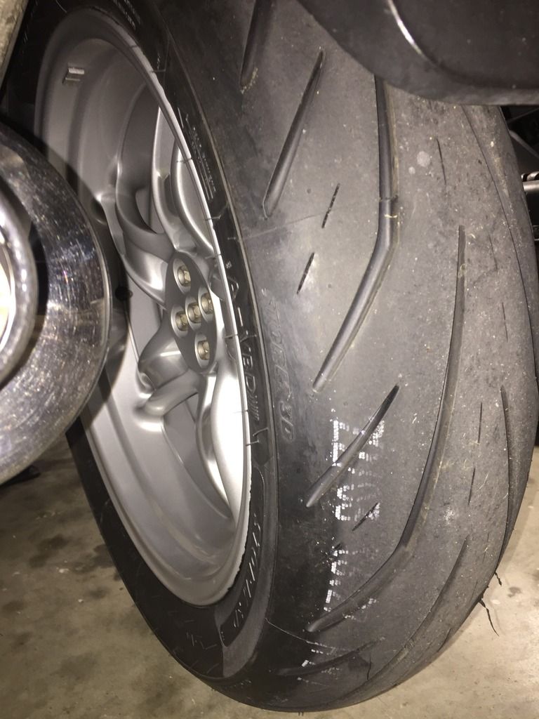

Finished installing the new rear Avon Storm 3D X-M.
New set of tires.. Can't wait to try em!

I can't remember where I read it at, but mixing brands on a bike is not ideal. If I recall, the subject started about people putting car tires on the rear of their bikes. Doesn't take a rocket scientist to figure that out; tire beads are completely different. Tires are designed to match your pressures. Now, unlike a car tire that has a simple two axis pressure on a tire bead, a motorcycle tire has a 3 axis pressure on the bead. In a turn, the rear is subjected to acceleration/decel, cornering/g-force AND lean. The front is subject to accel/decel, but by varying force and pressure. When a motorcycle SET is constructed and designed, all of these forces from front to rear are accounted and the shape is made to compliment the other tire. By mismatching tires, you can actually overwork your suspension and the tires, causing a premature catastrophic failure.
When I bought my K1200LT, it had a brand new Pirelli Diablo on the front and a Bridgestone on the rear. At first, I never really thought too much about it, having to counter steer in a highway speed corner almost felt natural. At low speeds, the bike was completely unstable. After putting 5K on the bike, the front went away. I replaced both front and rear with Metzler's. Since then, cornering is effortless and smooth. The bike probably took about 6 naps with the mismatched tires and is yet to go down since replacing them almost 7K ago. Still have a considerable amount of tread on both front and rear. My recommendation is NEVER mismatch tires, always replace in pairs and only in cases such as a flat tire or damage with more than 50% tread life replace them one at a time.
Sent from my SM-G935V using Tapatalk

I tried a BT020 rear tire. Metz on front still good. Loved it. 8500 miles later (the most I've ever got on a rear tire), another new BT020, and mounted an un-wornout Metz I had saved from when I wanted to start a trip with fresh tires. 48/42. I think I've found the perfect combo. No, not perfect, best for me.
