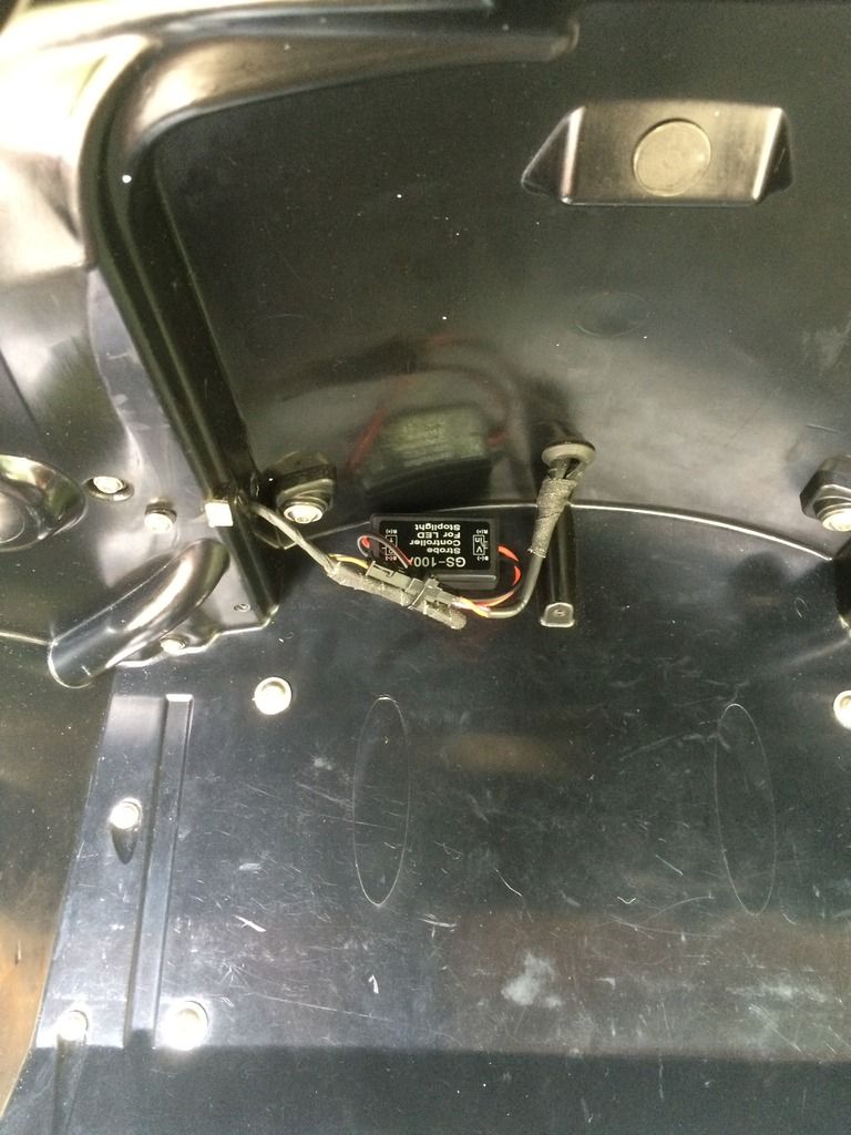

For anyone else that like's this idea, here's another option.
It's a GS100A controller hooked up to the LED on the top case of my 2003 LT.
Flash a few times then stay on.
About $3 on eBay.

I just installed the GS100A to LEDs on top case on the LT this afternoon. Purchased at Amazon.com for about $5. The install was very easy and the results are excellent.

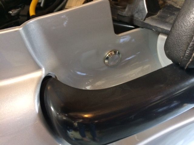

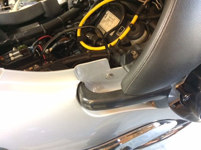

Wish I could help. I modded my 03 with an 05 center-stand.
None of the safety features are involved.
Wired directly to the battery, uses this button.

I installed the GA-100A with no problems, no issues. Took less than 10 minutes to disassemble the mirror in top box, solder in series the flasher, shrink tube and reassemble.
