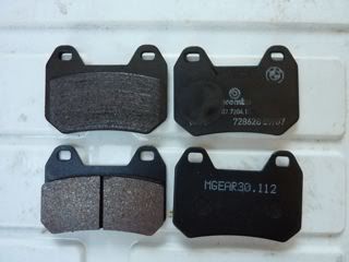

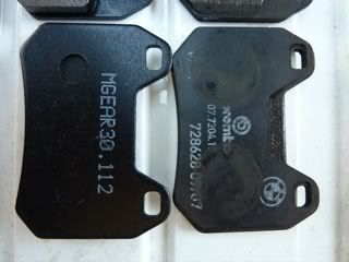

post #6 of 6 Old Oct 17th, 2011, 6:25 am Thread Starter
Posts: 3,185
Re: Rear brake pads....
The EBC pads haven't arrived after 5 weeks, and so I bought a set of rears from Metalgear in Brisbane to get me by. $15.50 plus $7 postage... pretty cheap compared to all others I found online or enquired about.
Ordered late Friday afternoon, and they arrived first thing Monday morning....can't complain about that.
The pads' backing metal plate is much thinner than the OEM Brembo's, and doesn't have the extra metal plate attached that the Brembo's do (whatever its for... anti-squeal maybe?).
They went in without any issues, only took 5 minutes to swap them over, hopefully I've done it right...
Quick test ride and the bike pulled up OK, although the front did wobble violently with just the rears applied heavily (don't how how much front gets applied with the linked brakes when only using the rear peddle).
Here's the main differences in pics....
