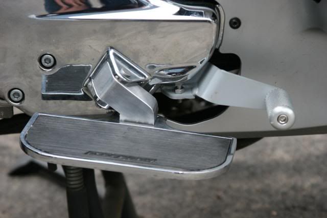

Well for the second time my LT has fallen down, actually it's now (16) but who's counting thanks to me of course, and as much as I love my foot boards the fact they don't fold up is is becoming financially prohibitive. about 300 bucks each time. I have tried to work out how to make them fold but I think I will have to take them off, shame as I love them

shit, just had a closer look... that's the cast part from the panel thats broken away?

yeah seen that one Chris. I have my fabricating mate welding them back on. what you see in the photo is what happens when they go over every time, its a shame the makers ie darius etc. don't make them to fold up, "(now there's a big hint)" I think I will just take them off for now, pity as they are brand new, made from stainless steel, I ground the originals off so much they were unusable, only used these once for my trip to sydney
From looking at Darius's site I think I can see what you have (had ), the relocated downward boards?
Surely with a little help from your manufacturing mate you could fit a hinge underneath somehow that allowed them to fold up in a fall? Might need a little trimming of his aluminium adaptor... and changing the location of the attachment/pivot point..... which would now be the hinge ?

Linton, can you post some pics of the aluminium attaching piece and the underneath of the footboard?... just out of curiosity
post #10 of 20 Old Aug 12th, 2014, 8:10 am Thread Starter
Axle's Avatar
Location: portland, victoria, Australia
Posts: 1,491
Re: foot boards and falling over
here ya go Mate

All fixed up just in time for the weekend

Well done Lonton,
Nice job.

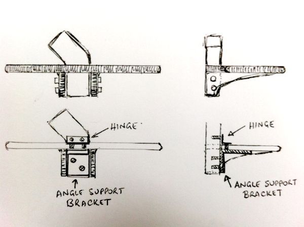

Excellent, he's done a nice job..... but still gotta come up with a way to make them hinge I feel.... or its only a matter of time, again... (thinking cap going on)....
OK.. here's one possible way to do it without cutting anything existing except for drilling/tapping some new holes and adding a support angle bracket and hinge.

That is one sweet weld repair that guy must be an artist at his craft. Pass on my regards for a job very well done.
Yep that Looks like a great alternative I will take a look at the possibility

I thought you could have just done that mod yourself at home, at little to no cost... which is why I suggested it.
nothing to weld... drill & tap 6 holes per side, and easy to swap back to fixed position if it didn't work out.
